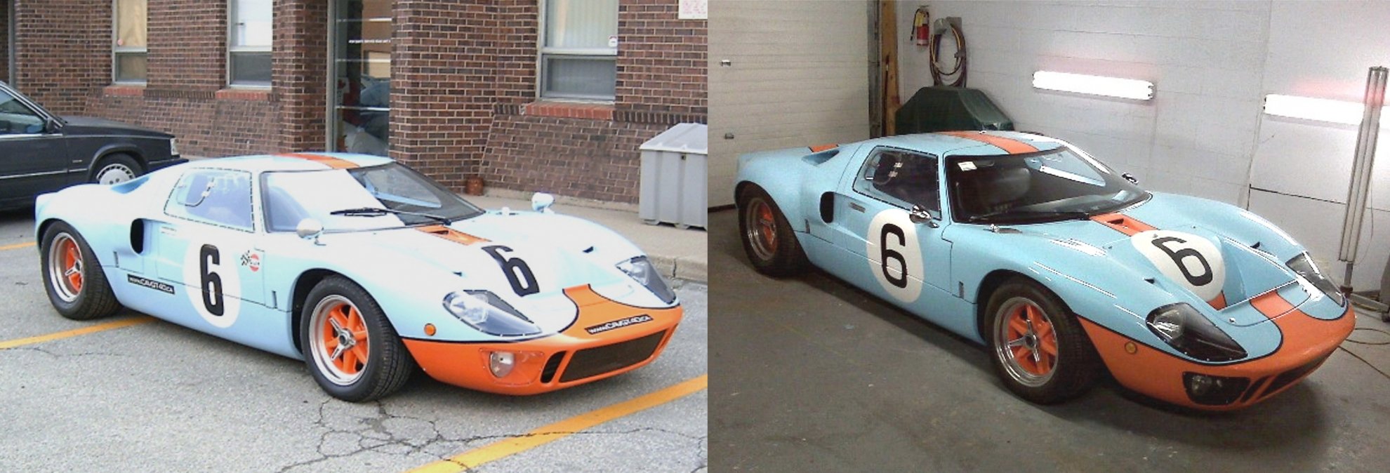

About the Gulf Colors, without bias, I can say the CAV paint codes listed on page 37 of the PDF posted above look right on the car.
The original colors were said to be Triumph (BMC) Powder Blue and Merigold Orange. Regardless the CAV codes will be as close as anything.
The thin stripe between the blue and orange is actually blue not black, a blue/black. The darkest blue we could find was a Mercedes color.
The "powder blue" requires a white basecoat if you want it to really pop. You will need more coats of blue and not achieve the same impact if applied over grey primer. Try it on a blowout card first, you'll be surprised. Even though it's a solid gloss color it needs the light basecoat.

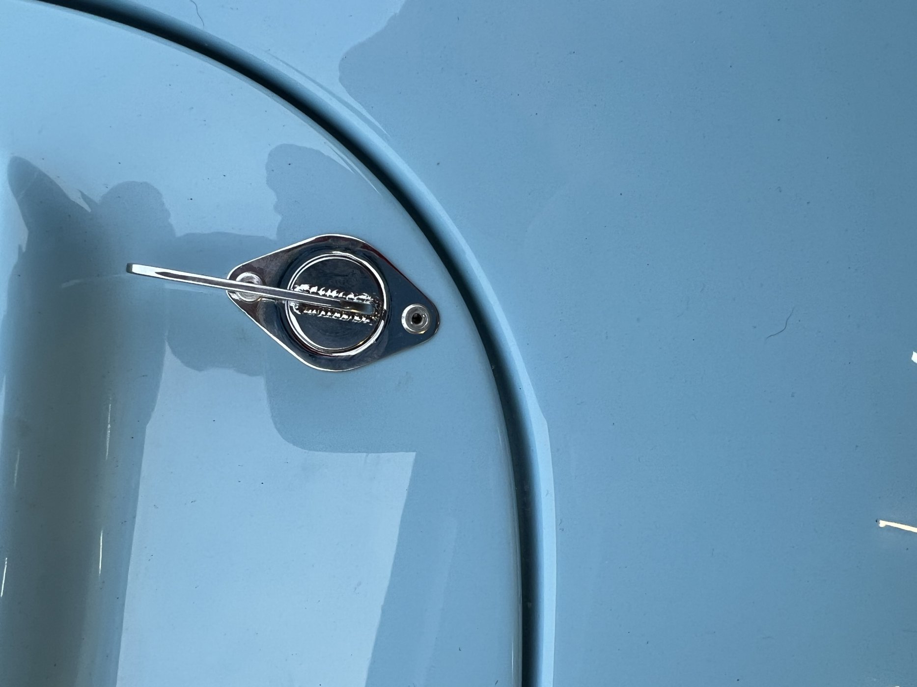

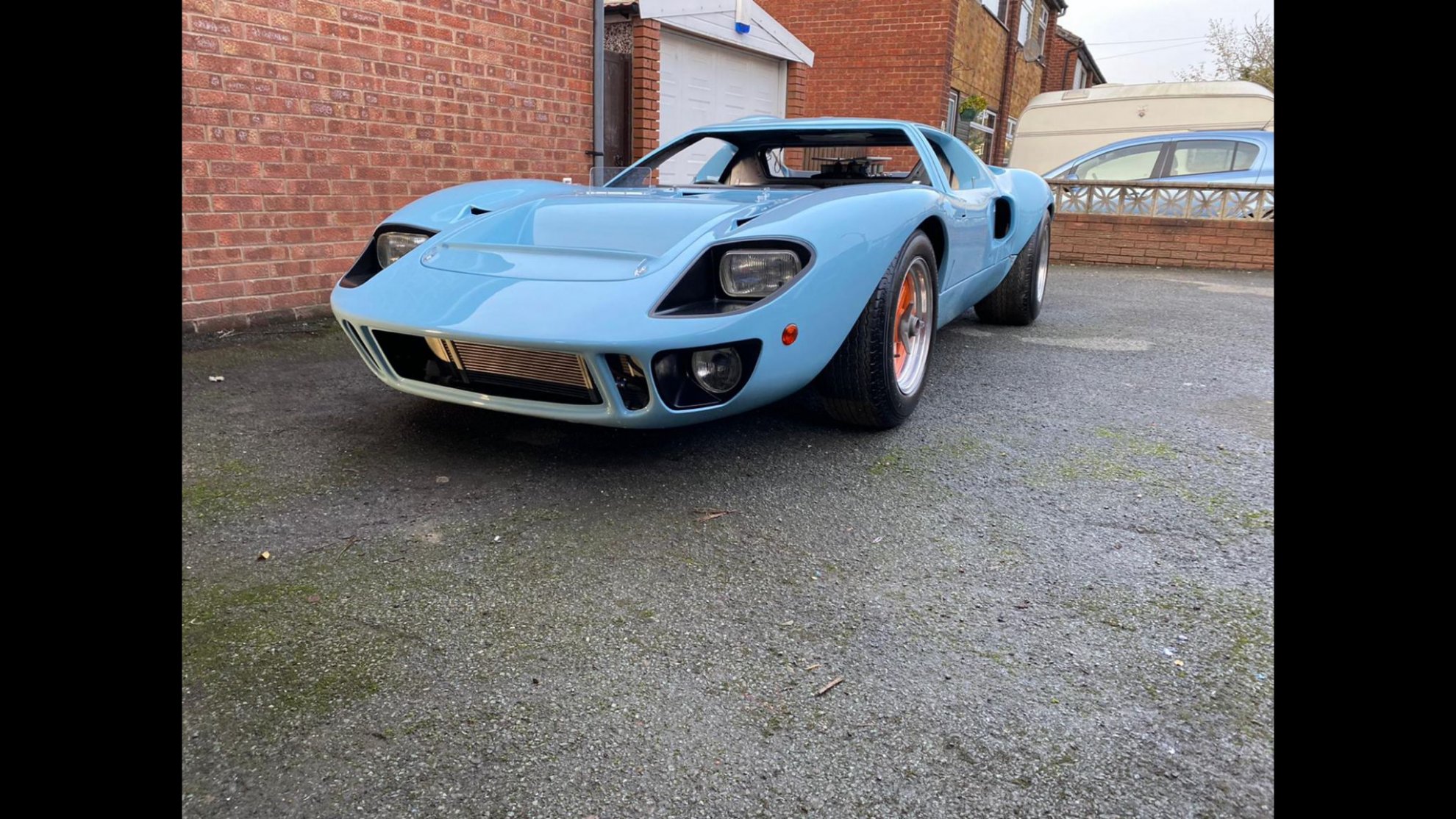

Sprayed last week, triumph colour not on white undercoat old style base coat and laquer not water based paint
