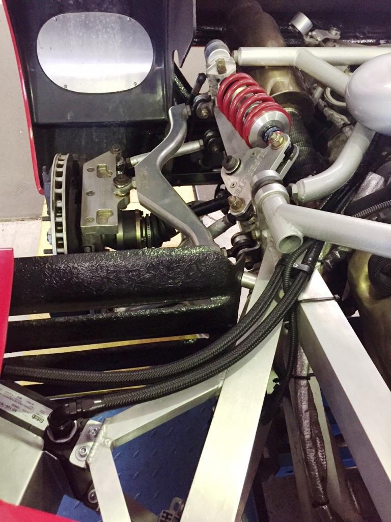

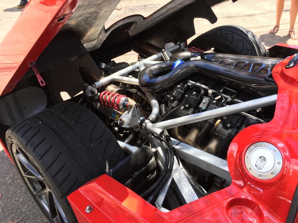

If you look in this video from 2:28 to 2:56 showing the engine oil cooler and Accusump you can see the connections... there appears to be two top connections and perhaps a bottom connection (at 2:37), maybe because of the Accusump?.
Sorry for the lack of specifics as I didn't do the install and I'm ignorant.
https://www.youtube.com/watch?v=-mIv7WOdTAQ
Edit for above...perhaps what looks like a connection at the bottom of the engine oil cooler is actually a connection for one of the hoses coming from the top of the cooler!
