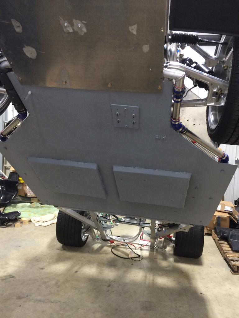

Can someone post a picture of the underside of the car? I am guessing it is flat, but I've never been able to find a picture. Has anyone attempted to make ground effect tunnels for the rear underbody work, or are there frame components in the way?

The SL-C chassis is what I have termed "jewelry". Other than a slightly
dropped floorpan it is flat on the underside. There will be no issues with fatigue.

As others have stated, underside is basically flat with the exception of the seat area if you opt to go with the dropped floor pan. It's optional so if you want a completely flat bottom don't order that. The engine compartment is open at the bottom so this area is exposed to the ground. At the rear both the street and race versions have a diffuser though the race version appears to be more functional (to me). At the front the street splitter can be modified with tunnels which are already incorporated into the race version. I know a few folks have added close outs to the bottom of their engine compartment to keep airflow undisturbed beneath the car, just need to watch for heat build up.

image.jpgUnderside photo...

Awesome, thanks! Has anyone covered up the void below the rear sub-frame? And are you just holding the car up in the air with one arm while snapping a photo with the other!?!?!
Aaron - looks like you strong armed that into the air! Did you coat the underside with something?
