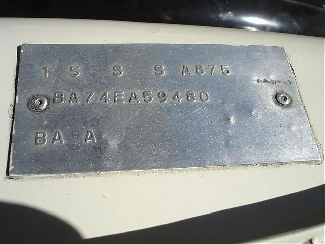

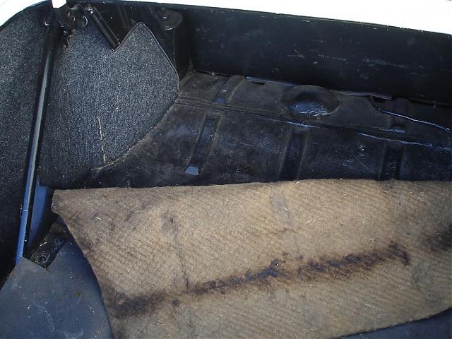

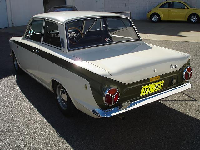

Hi I found this Lotus Cortina for sale and would value any opinion on it's authenticity. Below is the description I got from the seller and some photos.
Peter
Thanx for your enquiry .
This car was imported from Zimbabwe in 1989 , and has had one Perth enthusiast Ford owner since .
The car has been inspected by the local Lotus guru , and he has confirmed it's authenticity , the factory reinforcing bars in the boot , continue on behind the rear pillar , a sure sign that it's genuine , also the white painted plate under the bonnet attests to the fact that this is a RHD built 65 Lotus .
This car has had the rear A-frame replaced as with most Lotus cars , as the bad design fault incorprated in them caused the diff housing to flex , and either break or produce interminable oil leaks .
The factory mountings for the A frame are still in place , also the hump in the boot for the diff clearance is present .
The car is in excellent condition , as it has not been a race car here in Perth .
We would welcome any inspection .
Regards

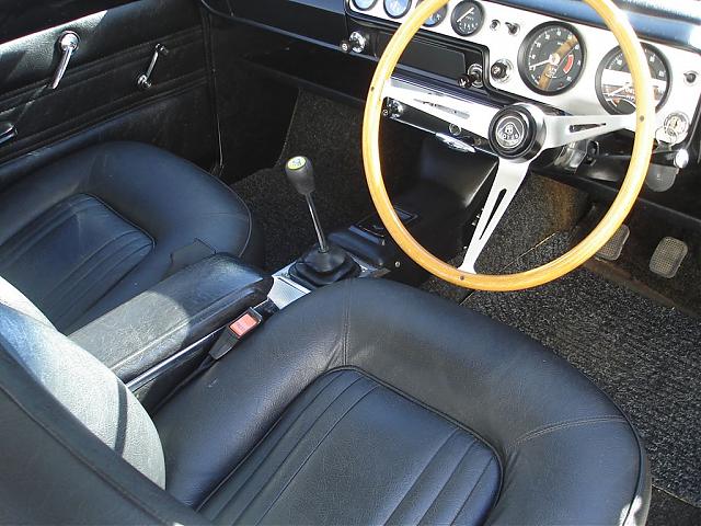

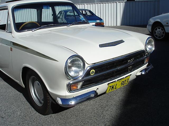

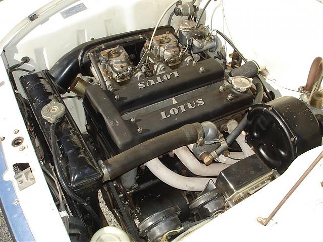

Some more pics.

I've only seen one in the flesh...many,many years ago and it was LHD of course. It appears to be genuine, but they are only pics. I would think that Lotus could authenticate the # if there is any question regarding real or not. Since I have worked on probably 20 various Lotii over the years, the fact I have only seen one of these makes be believe they were pretty limited.
Ross Nicol
You see Pete, that's 2 of us onto 1 of you, now where's JacMac. Anyway with a GT40 and Ferrari in the garage you'll be disappointed with the 120hp that Cortina has, and did you know you have to pull the head off to fix the water pump? which shits itself regularly.You'll note my Europa has a nice 170hp Toyota motor in it, makes the 680kg car go like a rocket, just can't stop it with the original brakes.Anyway if you go further with this Lotus Cortina, when you go to look at it take a magnet with you, if it sticks to the door skins, bonnet or boot lid it's a fake as they are aluminium on a real Lotus Cortina MK1. You could go by build plate but as you know from GT40, you can buy a plate and rivets are easy to drill out.Hell Lindsay Fox (the Australian trucking legend) bought a plate for a Gull Wing Merc. The plate was from an American write off, and he built a new car around the plate. He is known to have more Gull Wing Mercs than the factory but his restoration practices have been questioned. However I'm not sure us Kiwis are going to care if you get stung. How much money are you sending per month to Nigeria? Seems QLD is highly represented with involvement in that scam, hard to believe anyone could get sucked in by that one.
Ross:D
Along with the alloy panels, the -Bell Housing- Gearbox extension housing-& Diff Head casting should also be alloy. You should definitely buy it Pete, after you set the tappets a couple of times- have fitted a Head gasket or two- welded up the head to get rid of the corrosion-paid the speeding fines because you wont be able to resist the sound of those side suckers- and then realise those green stripes are just cop bait you might at last ' see the light ' and start picking on the Poms who built this lovely motorcar so that you could pay many times its original price for 42 years later!
Hope that helps with the purchase decision!!

Pete McCluskey.
Thanks guys, you have made me laugh,and Ross and JacMac the magnet/alloy tips are good. Thanks. The problem is the thing is in Perth, a long way to fly to discover a clone.:o
