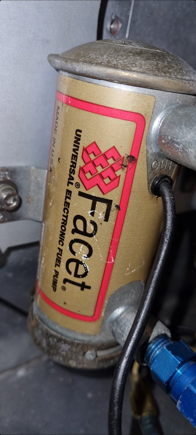

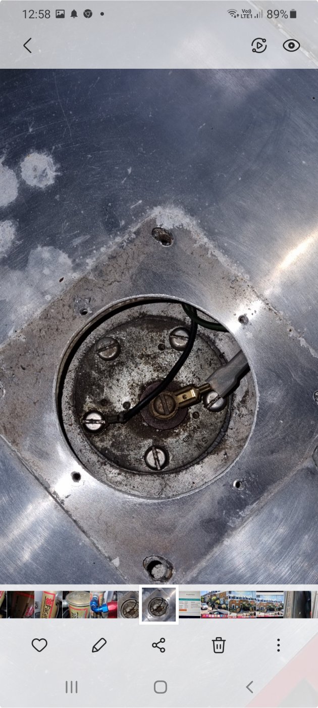

Can anyone please advise me where I can buy in the UK a new fuel pump and fuel tank float assembly for my 1990 GTD the pump is banging a bit and I can smell fuel when I'm driving even though I have checked and can't see any leaks so not been using that side have attached a couple of pictures have a good day and thanks cheers

I just bought replacement fuel pumps from Rally Design, cheapest place for the same item about £90 each inclusive VAT delivered. I think Europa Parts sells the basic fuel meter assembly?

Mike sorry to bother you again how do i know what fuel pump to buy there are 3 different ones with different pressures not sure which i have or how to tell

It depends on your carb(s). Webers need 3psi or a bit less. Holleys 6/7psi. The pump will be a bit more than this and it will be reduced through the pressure regulator. Temporarily attach a fuel pressure gauge to check that the pressure is set correctly. I remove the gauge then as it’s not then needed and it’s one more failure point for a leak.
Webers work best at approx 4 psi of fuel pressure (Not 2 psi like many of the older books stated.) and you need Volume not Pressure to keep the float bowl full of any carburetor.
Fuel pump specifications:
Facet silver Top, 36 GPH free flow, 23 GPH @ 2 psi. 11.5 GPH @ 4 psi.
Facet Red Top 40 GPH free flow, 35 GPH @ 2 psi. 20 GPH @ 4 psi
Facet Blue Top, 45 GPH, 38 GPH @ 2 psi. 23 GPH @ 4 psi
Facet Dura Lift 40285, 33 GPH Free Flow, 4-7 psi @ no flow.
Facet Dura Lift 40222, 33 GPH Free Flow, 9-11 psi @ no flow, 17 GPH @ 4 psi
Facet Dura Lift 40290, 50 GPH Free Flow, 12-15 psi @ no flow, 20 GPH @ 8 psi
Holley Red flows 97 Us Gph free flow - 67 Us Gph @ 5psi
Carter P4600HP flows 100 Us Gph free flow.
Steward Warner 240A, ?
Webers run 3-4 psi fuel pressure.
Holleys run 6-7 psi fuel pressure.
The more pressure a pump has to deliver the less GPH is pumped by the pump. That’s why we are not interested in free flow numbers given by the manufacturers.
Modern fuel pump calculators calculate:
250 bhp you´ll need 24 GPH @ 4 - 7 psi, that’s about max a Facet Dura Lift (40290) can handle.
350 bhp you’ll need 33 GPH @ 4 - 7 psi, so that leaves a Facet Red & Blue Top out.
400 bhp you’ll need 37 GPH @ 4 – 7 psi.
4 psi for the weber carb, 7 psi for a Holley carb.
Facet Red & Blue top pumps have no flow at 7 psi while Holley recommends 7 psi at idle, and a minimum 4 psi at engine redline for their carbs. So that rules a Facet pump out when running a Holley carburetor on any engine.
You also don’t want to be on the edge of a pumps capacity cause as the pump wears it affects its GPH.
Especially the Facet Red & Blue wears out fast. Unless you don’t drive that often.
If you run multiple carbs, you’ll have to take into account multiple float chambers have to be filled at the same time and rate. And as multiple carbs have multiple pump jets you’ll need some extra capacity to keep up the demand.
Facet Red or Blue pumps can be used if running them simultaneously.
Red & blue are the same pumps with the difference that the Red has a filter inside and the Blue not (no restriction hence the slightly more GPH).
My 50cents Holley red all the way.
