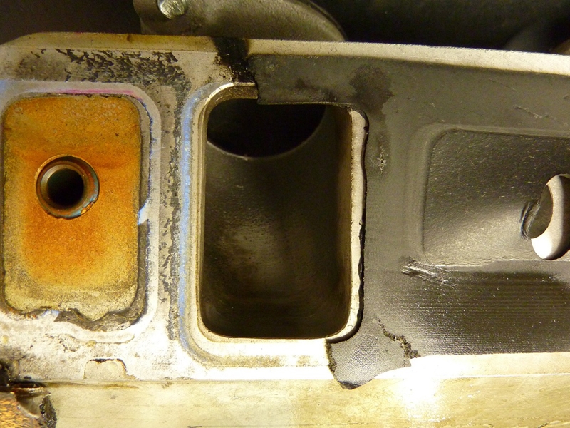

After pulling the intake manifold I found the intake gaskets totally shrunk, to the point where they have split at both ends and have large black soft carbon tracks indicating leakage through the splits.

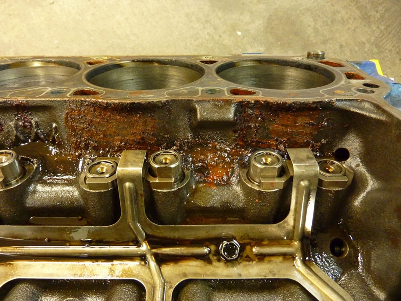

Further removing the heads I've pinpointed the leak at the head corners. It seems the strips of blue sealer on the gaskets do not line up on all passages on the heads and on the block.

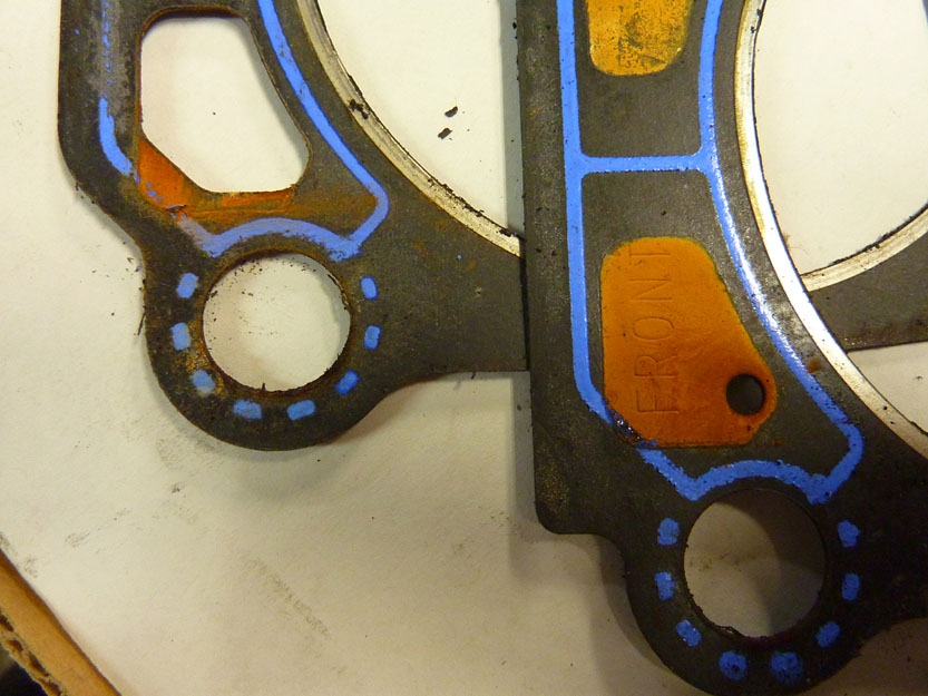

The head gaskets on the other hand, the Print O Seal did not line up in places with the water ports on the head and on the block. Especially the corners of the head. It leaked almost from day one.

Here's the leakage into the valley
Here's the shrinkage on the intake gasket. It pulled inwards so much that it cracked and was leaking at all 4 corners, note the black carbon track. Also note it pushing up against the mounting stud. These gaskets were closely port matched, now they are off by 3/32". Called AFR and Summit, both claim the FelPro is the premium gasket and neither have heard of this issue. Only thing I can think that's abnormal is the slight overheat.
Here's the coolant passage alignment problem, this is on the head side. The AFR heads don't exactly match the block. They match close enough but when the "print-o-seal" (the blue sealing strip) comes into the equation it's over the edge. May just end up using some sealer because the metal gaskets are like 3 times the price of the FelPro. The rust stain that shows the alignment is from running straight water right at first.

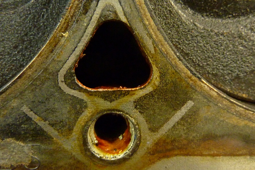

Here's where the block doesn't line up with the print-o-seal. The triangular ports in the block are a little off center, not enough to be that misaligned with the head but enough to be misalinged with the print-o-seal. The lighter colored strip is where the blue print-o-seal was resting.
