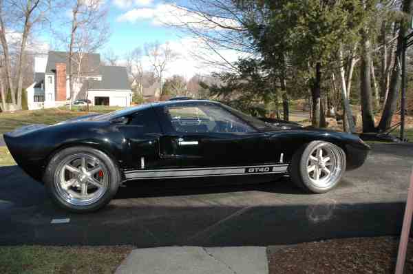

I am just about ready to register my ERA GT40. Era #2076
Picked the kit up 11/04.

I ended up buying everything from ERA to finish the car. I'm really not a shopper. I want everything to fit correctly and work together as designed. I build a ffr COBRA before this. I purchased things in advance and ended not using them because i didn't understand the spec or a plan change. I felt i over spent because of these kind of mistakes. The GT is very costly to build and i didn't want to waste money on parts that were not correct. When you purchase options from ERA they pretty much put it on the car and test fit it. ERA Has all the parts to built the car to completion. I enjoyed the build tremendously. THe car is much more complicated to build thane the Cobra. Compartments are smaller and more things go in a very small areas. Its not impossible but you won't muscle your way to completion.
The body requires a tremendous amount of work. The kind of work i don't appreciate but greatly respect those who can. I chose to have one of ERA's painters paint mine. I wanted someone who was familiar with car to paint it. There were some oops while building. If i had to to it over i would tape up and cover all painted surfaces while working on the car. Anyway its going back to the painter for touchup. The car is black so i understand touchup is not an issue. IF you go metalic touch up becomes more difficult.
The Support staff at ERA is just unbelievable. Great people to work with. They never grew tired of my anal questions. I live about 20 min from ERA so i was able to stop in as often as i needed. I was able to take pictures of the their cars and use as a reference while building mine.
The build manual is great but a picture of the real thing is the best. Ted who is their main builder of all the turn keys cars know all the tricks. When i got boxed into a corner one of Ted's tricks always bailed me out.
All i can say is great product, Great service and outstanding people. It does get a little expensive but you know the saying you get what you pay for.
