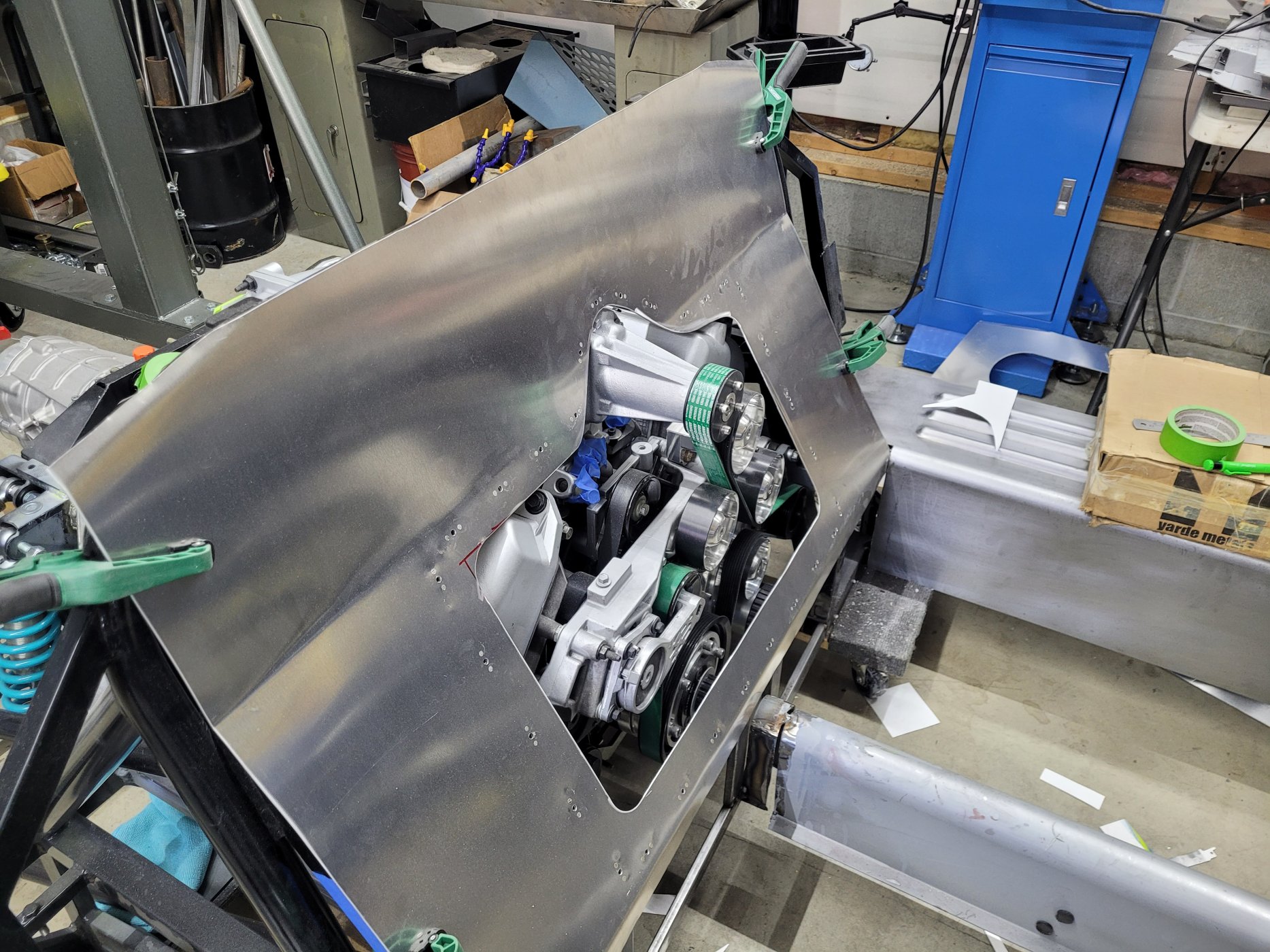

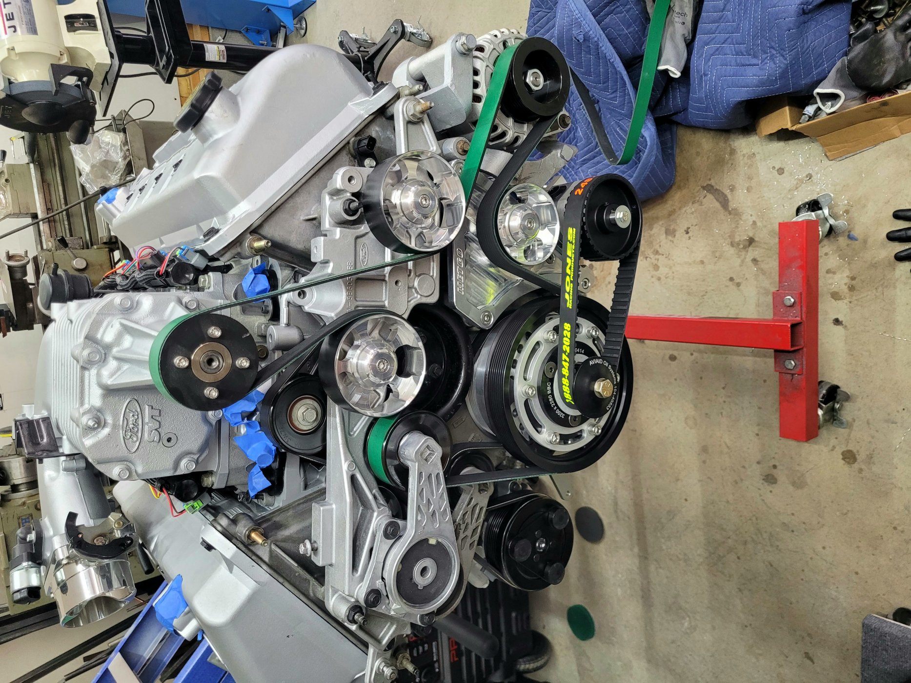

I fitted one into the SGT/ AK frame, had to modify it a little to make room for the extra accessory belt system the 4.6 dohc used for the supercharger. A 5.4 would fit just the same but wouldn't have required me to adjust the frame as much. I went dry sump. Made my own mounting supports for the pump and placed it where the power steering would have been and modified the metco brackets to aid in the relocation of belt pulleys.
The coyote setups are a lot smaller dimensionally so they fit way easier btw.
Superformance also stuffed a GT500 5.4 into one of their frames
Everyone forgets about this guys too:
