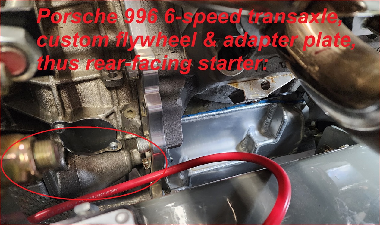

The main 2G battery wires to/from starter, and 6G wires from battery to fuseblocks:

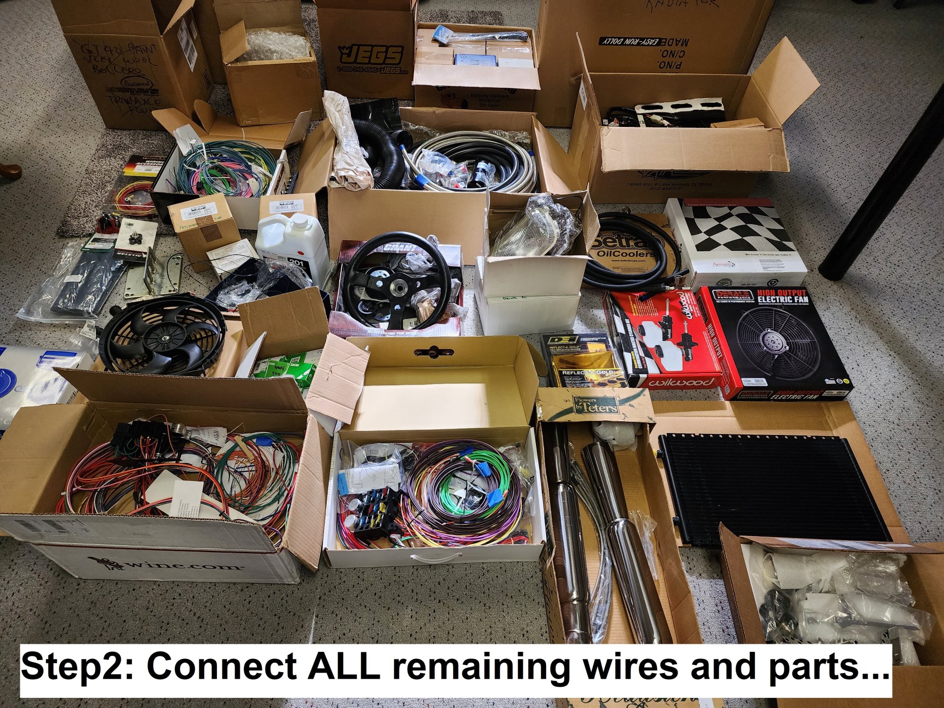

Trying to get the kits to work:
The nightmare:
Leftovers after all wiring completed:
