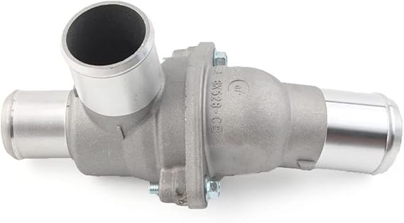

Is anyone familiar with this unit:
I can't find this on RockAuto - all the Jag units appear to be multi-outlet plastic manifolds. Close-ups of the unit clearly show the Ford part number F53E-8K528-CB That number also ties into some Mustang and Lincoln 4.6 usage but again, the unit just doesn't show up in the normal channels.
Any input on the piece? Usable? Problems associated with it?

I have used this unit before with good luck. There are some cheaper knockoffs out there, but I know this is a quality piece. I have made something similar for my build. The .500 port you can run your bypass.

I’ve updated another thread regarding this type of Stat. The one I used was spec’d for the BMW 2002 as it had the temperature range I was looking for (but I’ll be darned if I can remember what that value was!)….
I absolutely believe that the recirculating system is precisely the right move. No hot spots, no air bubbles…
if it is the thread I am thinking of, and its the BMW E30 thermostat used on the M10 engine, then its an 80°C unit. I could not see a way of changing the thermostat for ones of different temperatures. my understanding is that Ford normally run a 91°C thermostat on the Windosr engine. This may impact the emissions output of the engine if its operating at a colder temperature. This may be a factor if you have to pass any form of emissions testing.

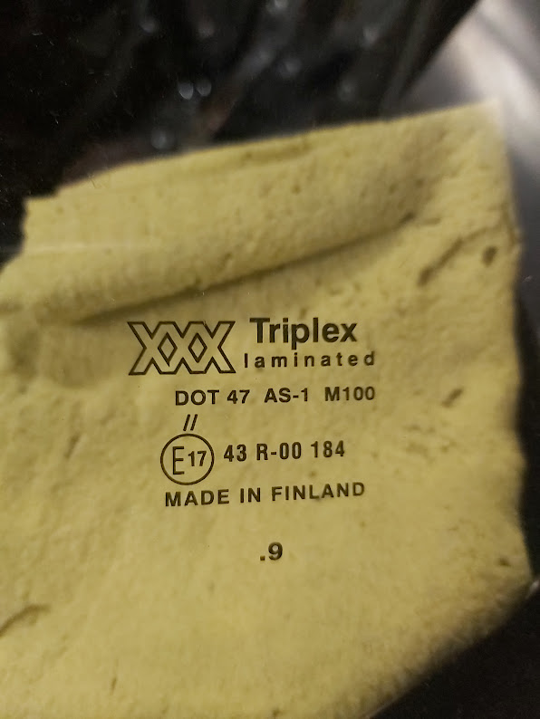

JP, can you share more information regarding your heated screen. Thx much. Randy
Comes in any colour you wish (mine is bronze tinted). Genuine Pilkinton Triplex XXX
