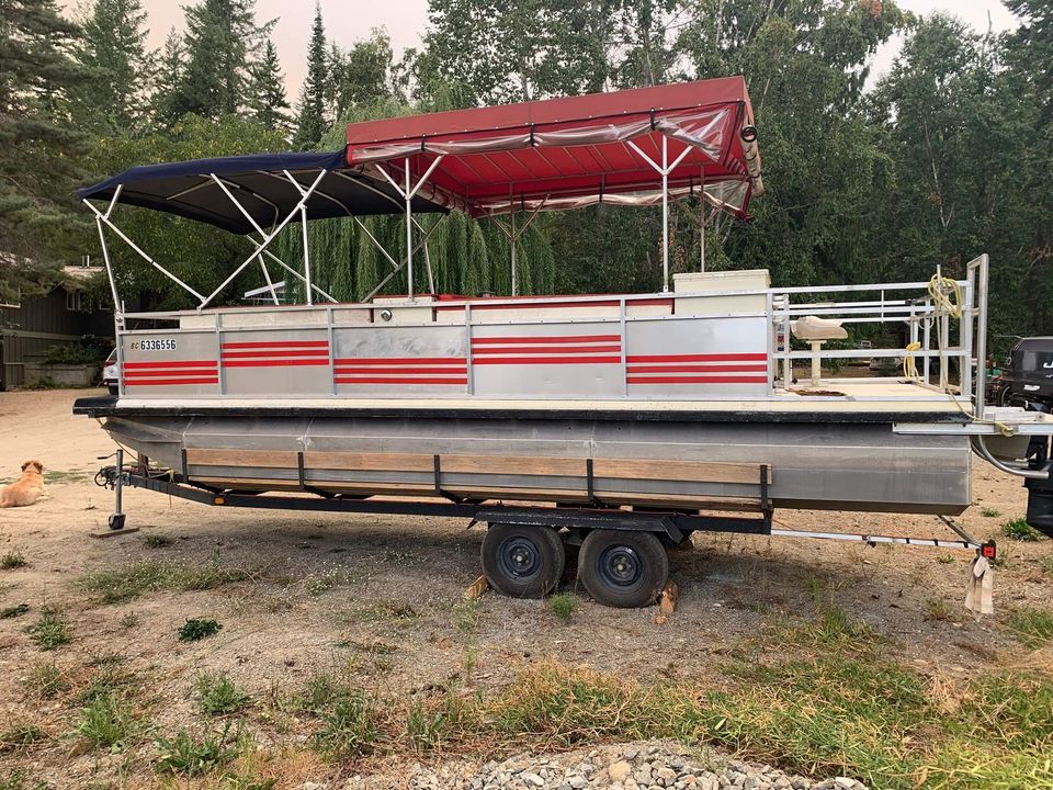

I've had the idea for a few years now about drifting the Yukon river from Whitehorse to Dawson City in the Yukon. At 70 years of age I should give my head a shake but last month I bought an old aluminum home made 24 foot pontoon boat with trailer and an old 130 horse Johnson outboard.
So far I have stripped it down to nothing and starting the rebuild. New vinyl deck, all new wiring, solar power, new 50 horse Honda, on demand hot water, kitchen, shower, sleeping area.

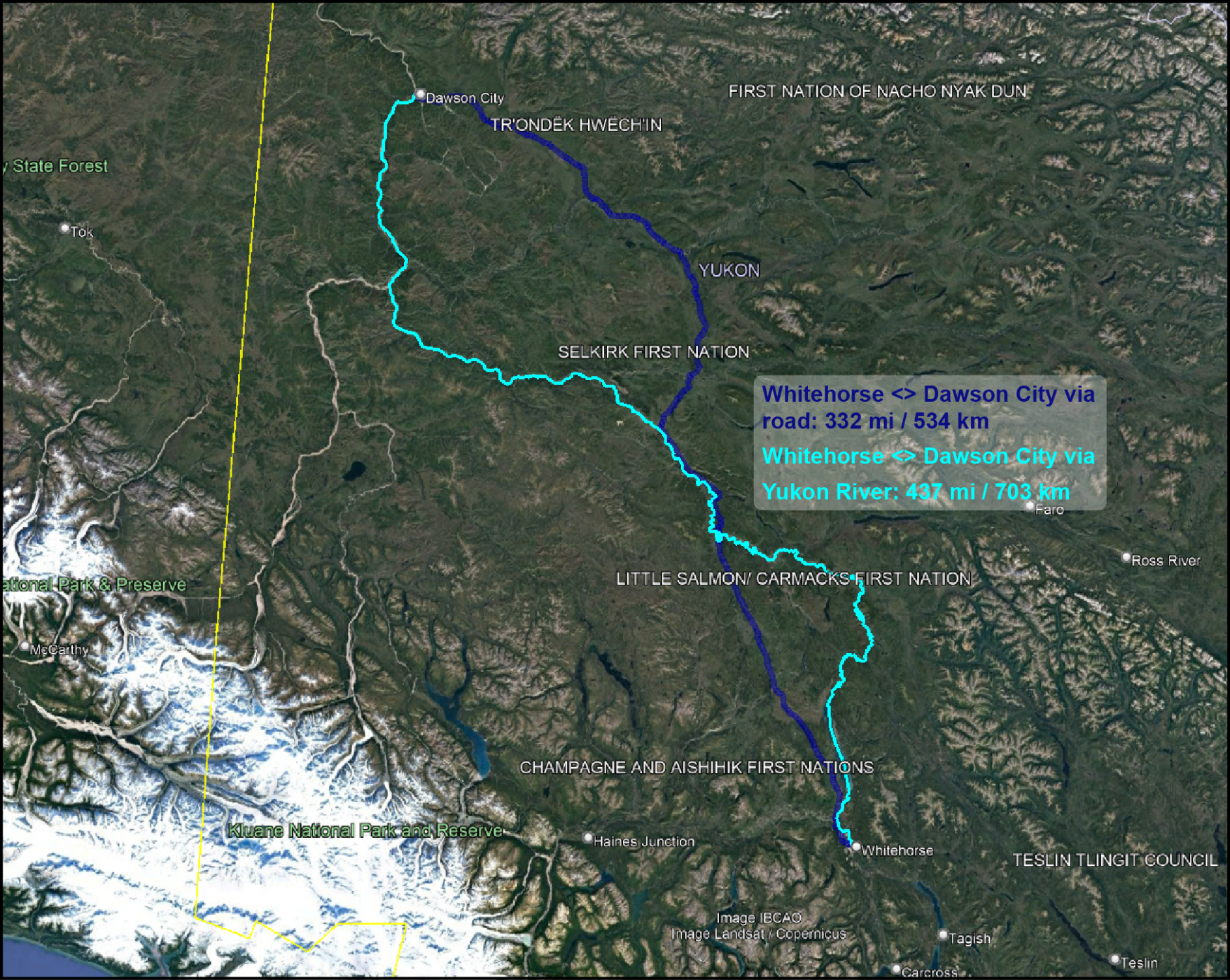

Hi Bill - I'm so intrigued by your Yukon River adventure that I made a precise KMZ file of the river route between Whitehorse and Dawson City - See below. I zoomed way in and made it follow the center of the river, to where you should even be able to navigate by it if you wanted; caveat: I avoided islands which are obvious, and shot for what looked to be the deepest water in every place where I could make such a determination ... but sometimes sand bars are hard to make out, so once out on the water, you might find I was wrong! (here and there, anyway :)) This is the kind of route plan I make for one of the services we do at work, so I know it works well, on roads, and along the Suwannee River here in Florida. If you think the file could be useful, I'll send it to you. I can also export to many different file types. The way we use it is, I export it as a GPX file, and then load it into an app called OsmAnd which is really good because before departing you can download the map background data for the area you'll be in, and then cell service isn't needed; it uses GPS satellites only when that's all there is, and it works great. Anyway, I show the river route as 437 mi (703 km). So if you could average 10 mph and motored 8 hours per day, that's about 5.5 days. Seems doable! Seems like a good trip!

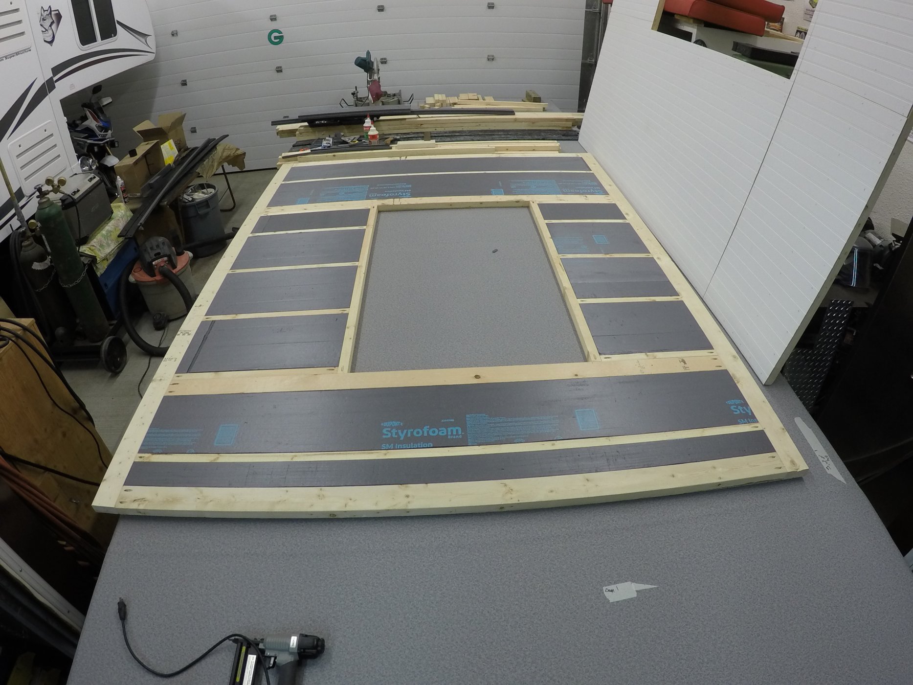

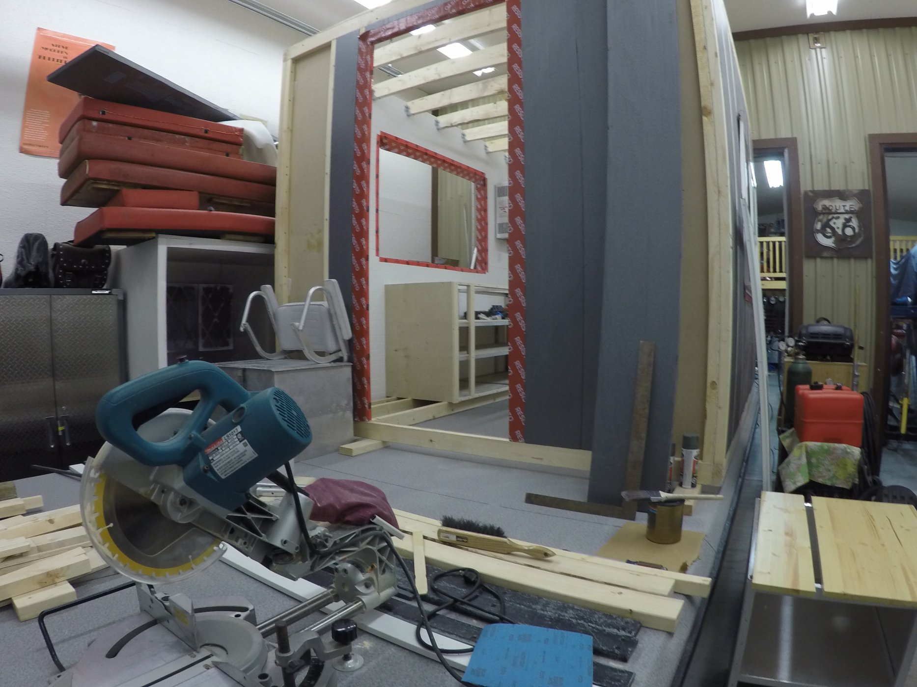

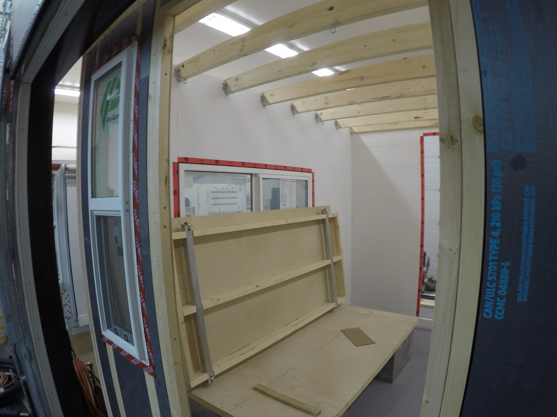

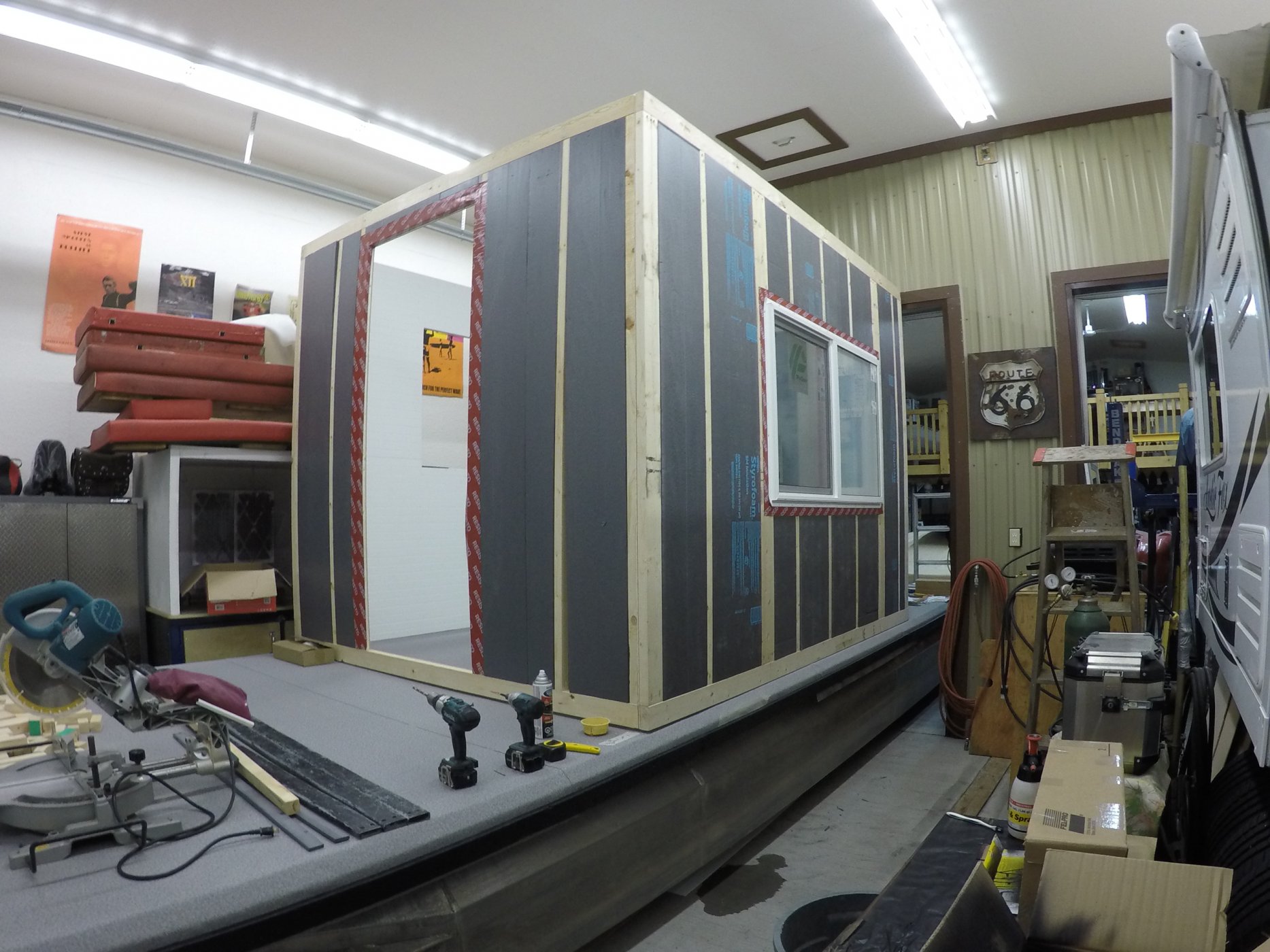

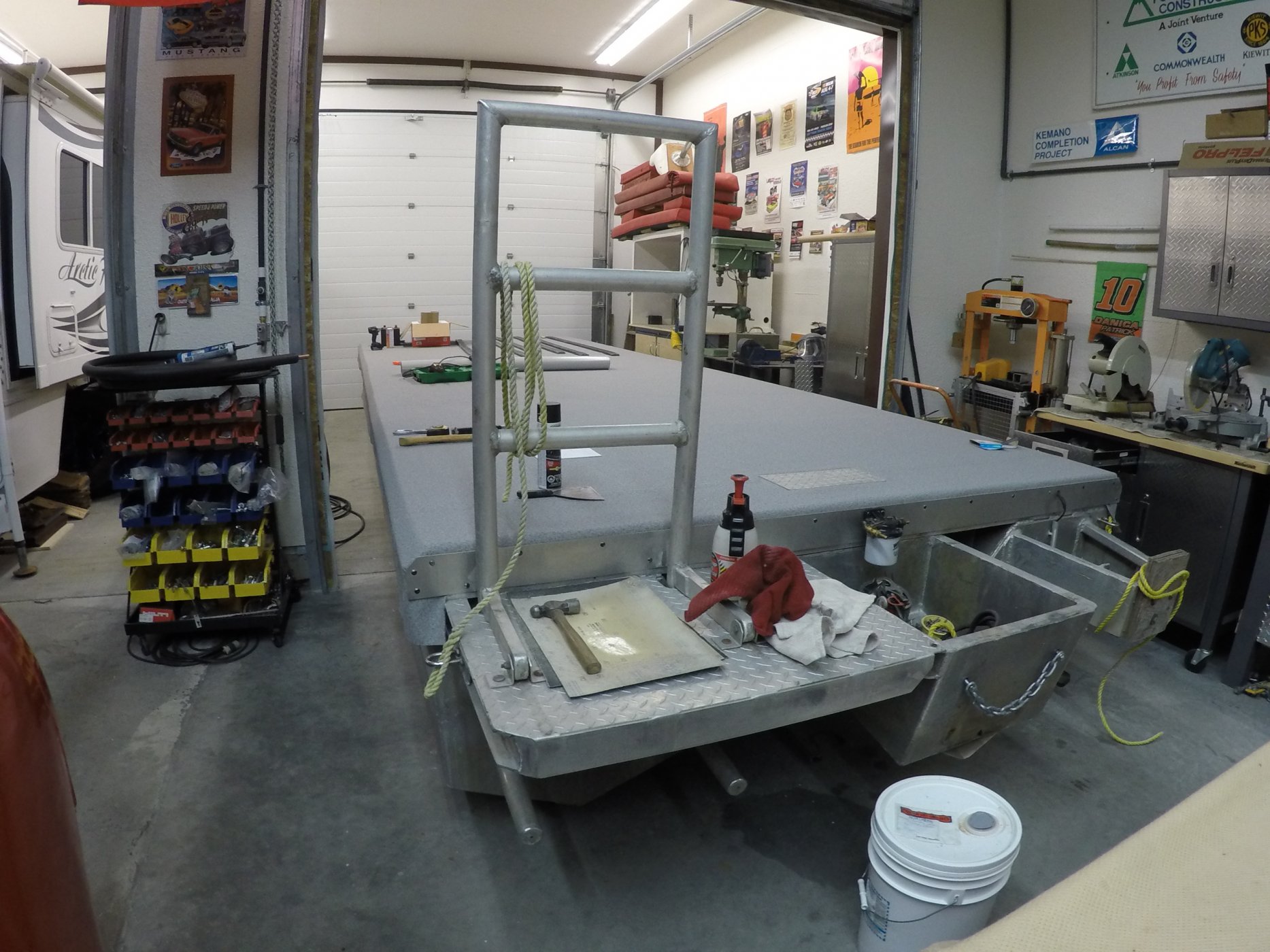

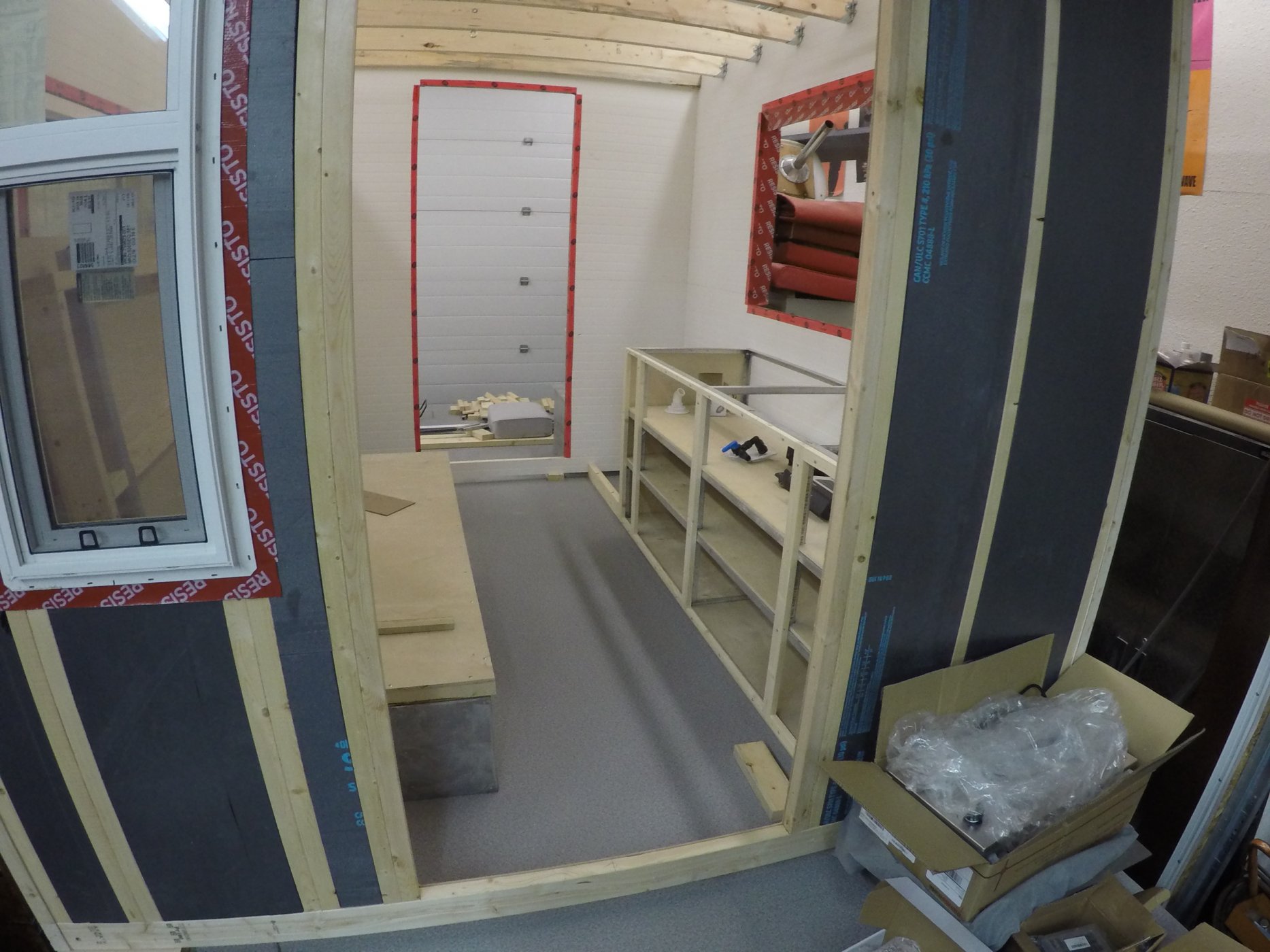

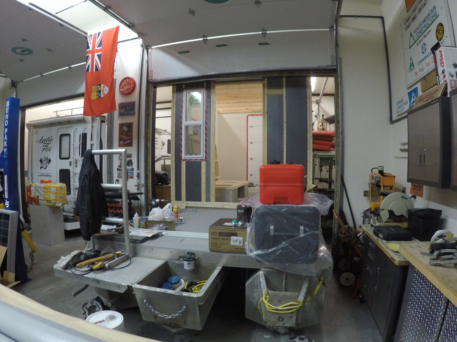

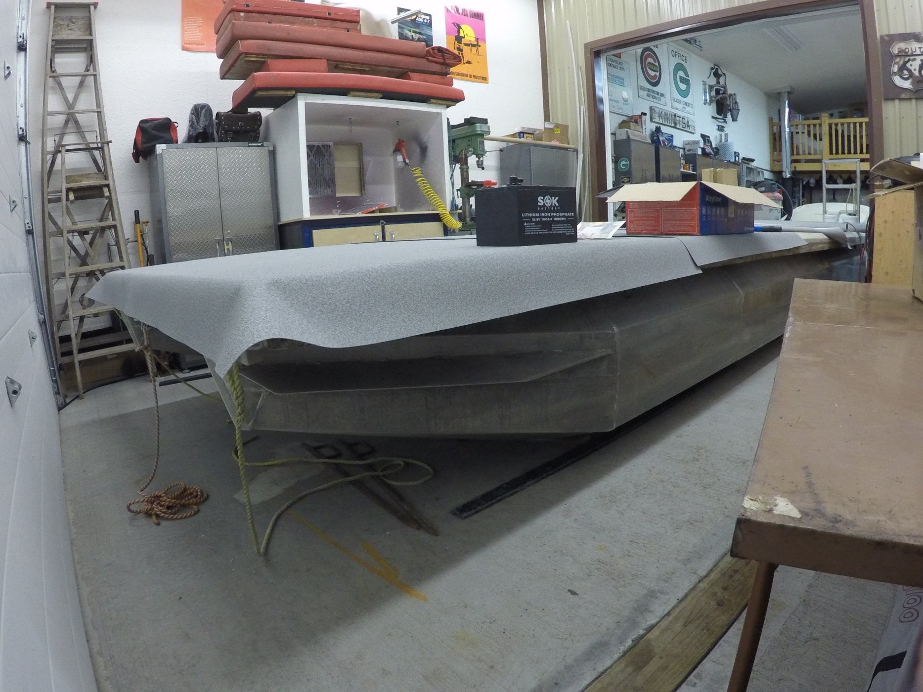

A little progress since December. I stripped the deck, sanded it and installed a new vinyl surface.
I will have to get into high gear if it’s going to get built for spring. I’m installing a propane system, on demand hot water, for cooking, and showers. Power will come from a battery and a 400 watt solar system for a twelve volt fridge freezer. , water pump and lights. I will install a small inverter to make 120 volt AC so the Boss can do her hair, HA HA. To save space, a bunk bed setup, Jane on the bottom that will also serve as an indoor eating area with an elevator bed that will be moved up to the ceiling when not in use, for me. Seven feet of counter space will have a cook top and sink above cabinets. A water tank, about 230 liters and a pump plumbed so I can select water from the tank or the lake as we choose. The helm is outside the front door on the right. New controls and hydraulic steering I have with outboards on order. One 50 horse main and a 15 horse kicker. I will try and carry about 225 ltrs. of fuel, we'll see how things are for the weight. probably 3 or four tanks I can move around to balance the load.
