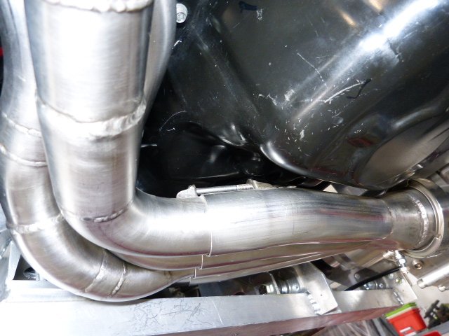

850rwhp 427 turbo Swaintech coating at 10+ years old, all-out racecar. Yes - ugly even when new:

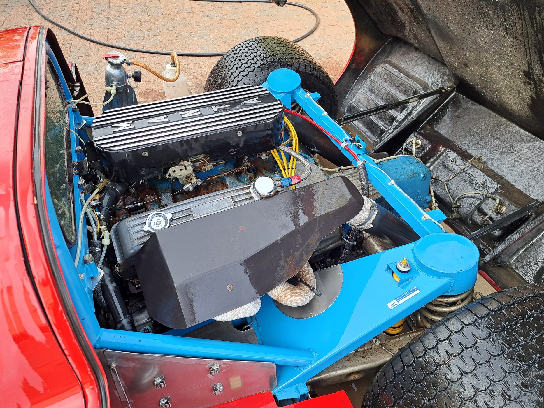

Previous 500rwhp supercharged Opentrack car, where I cared about looks too.
Silver-ceramic looks great, works well (just IMOHO, not as long-lasting as extreme race-duty Swaintech).

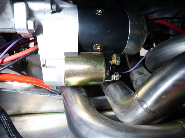

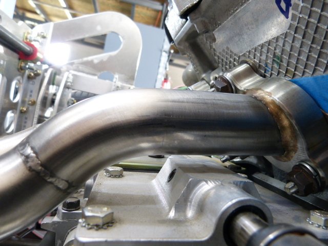

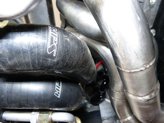

  3. My homebuilt Miura represents a really difficult case. There's very little air gap between the exhaust components and critical areas (e.g. firewall, starter, motor mounts, oil pan, A/C compressor, transaxle, etc.). Given this, I decided that a "real" heat control solution beyond the spray on coatings was needed. I decided to give the Header Shield product/service a try and we'll see how well it works once I make more progress. Even using it, I applied Lizard Skin sound deadener and ceramic coating topped by DEI firewall insulation on the firewall. I also plan to use some shielding on the starter as well.
