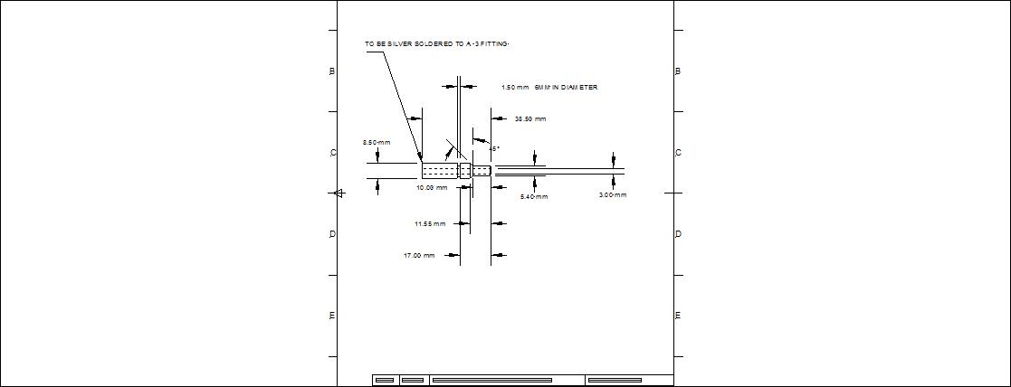

Craig 016 box's were fitted to Audi 80 and 100's from memory
Sorry cant help you with a part #.
Its the one that passes through the case and has a cotter bolt holding it in.
Last time I tried getting one of those it was a non event.
I ended up using the slave of the 01E 6speed and made a simple bracket to mount it in.
The OD is the same where it passes into the case but it has a bracket pointing downward at the rear of the slave.
The bracket attachment I drilled into the web on the transaxle case below the slave.
The 01E slave is plastic and has a snap in fitting, I machined up the fitting and silver soldered a -4 fitting onto it.
As you are a lathest her is a drawing to give you an idea.
I have a slave at work I can get a # of it if you like.
Jim
