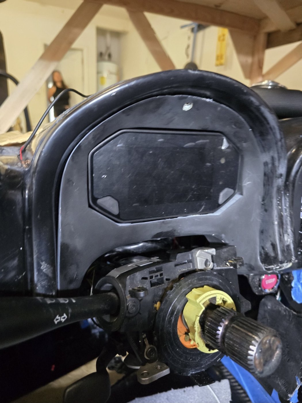

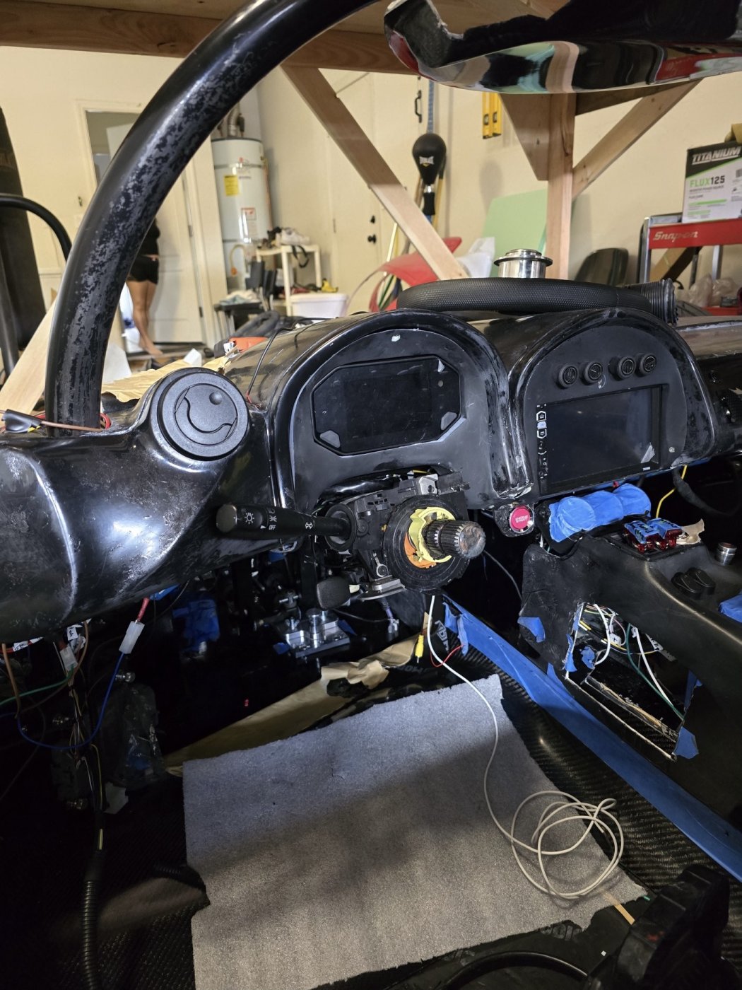

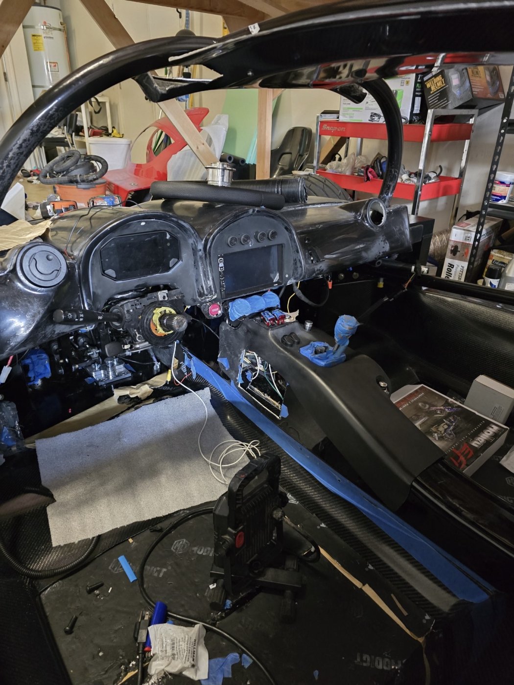

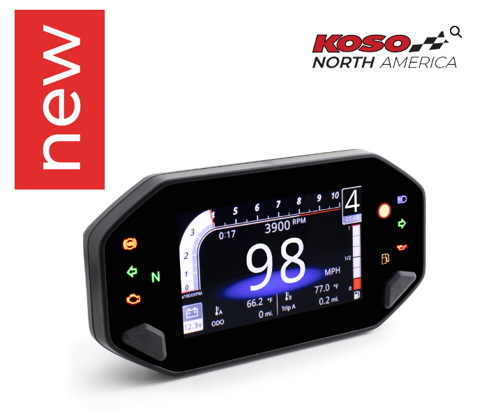

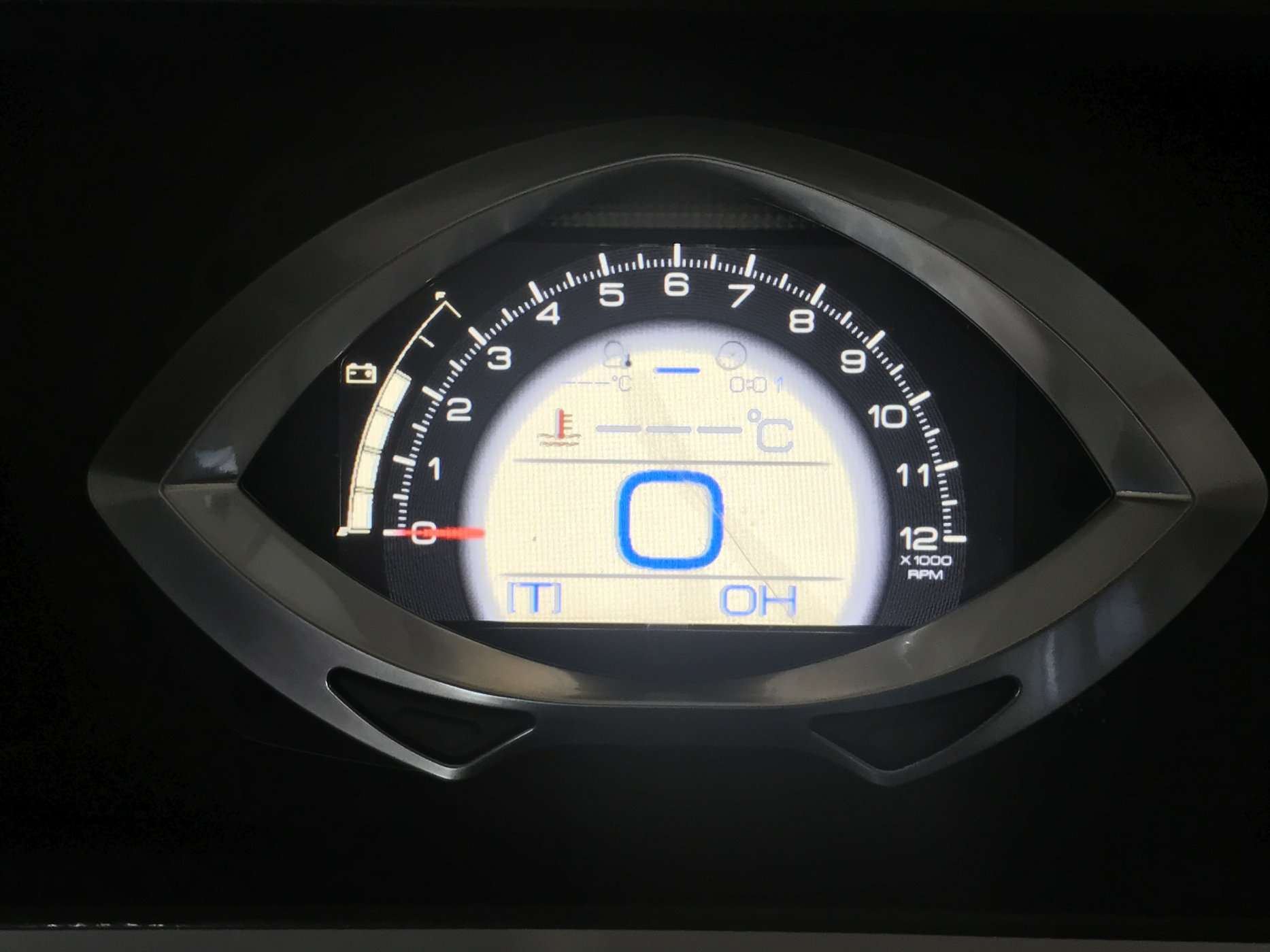

This is new KOSO gauge that was sent with my slc

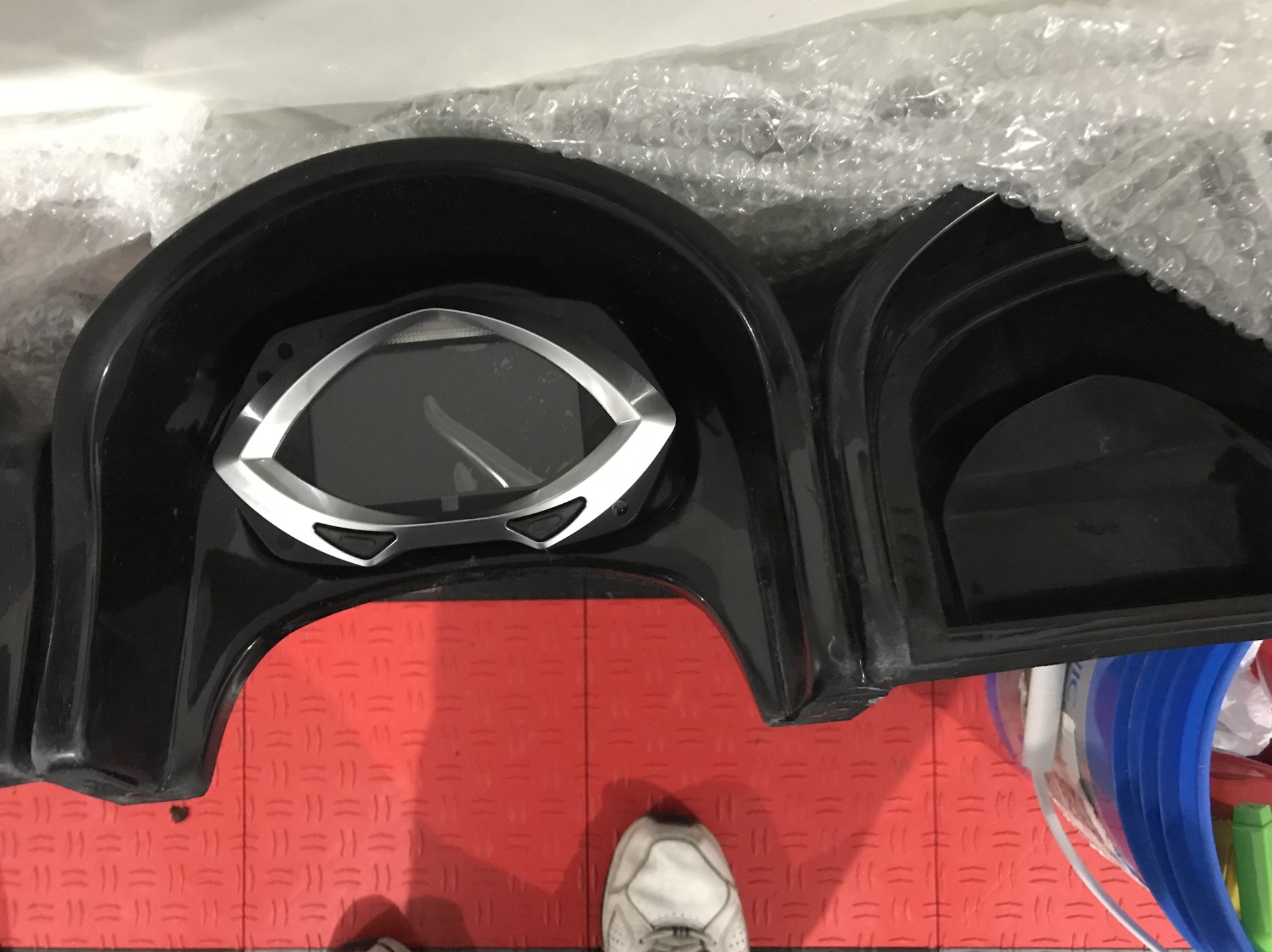

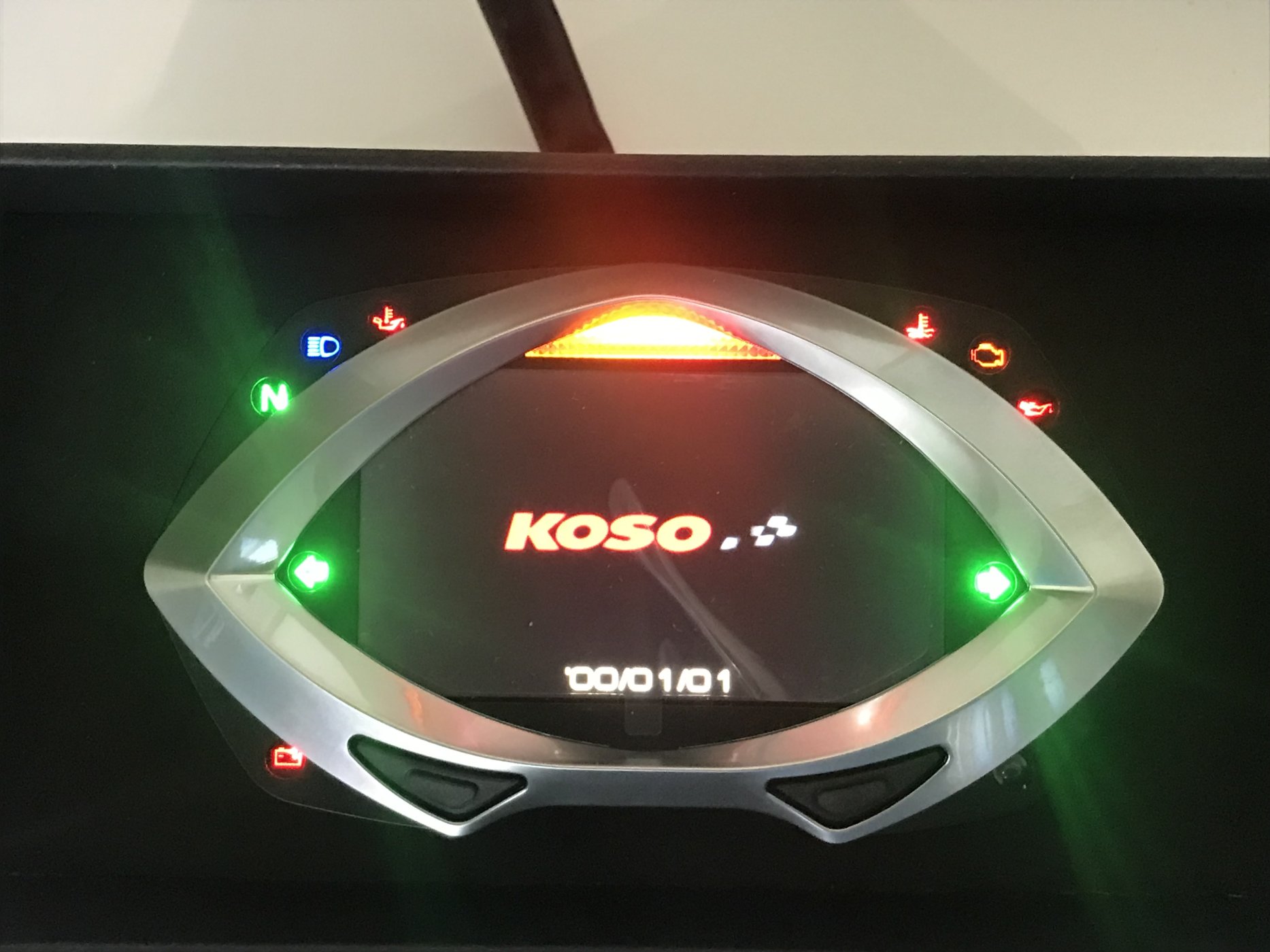

The wiki shows the round gauge which is no longer being sent.

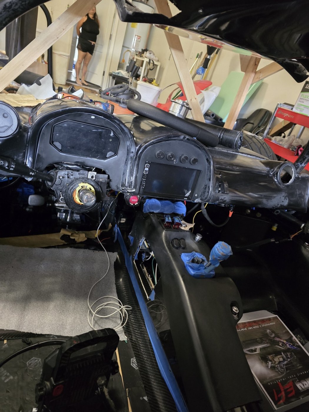

No not at all. Just showing what it looks like. It works and looks nice. I have the screen taped while I'm working to keep it nice.
It's unfortunate they went away from the Digidash the dash was designed for .... looks better and functions really good; I used it in all my later builds
A long, long time ago I read a very good book on "Human Factors Engineering". I think it's called something else now, but it addressed how to present information to a human in a way that is unambiguous, easily readable, and quickly assimilated. The main points having to do with aircraft instruments, indicators, and switches.
One important point was the preference for round gauges with 270 degree sweep scales. This type of instrument could be read in a fraction of a second, not by reading the dial scale, but by noting the angular position of the indicator needle (pointer). Linear scales are not easy to read; I once owned a car that had a speedometer that was a long horizontal line, increasing speed pushed the line further to the right. I hated that thing.
It seems that modern instrument makers are now attempting to squeeze too much information into a very small space and the lessons learned in the past are now forgotten. I am not a fan of digital displays as the primary instrumentation.
