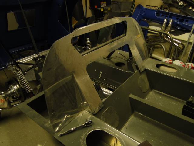

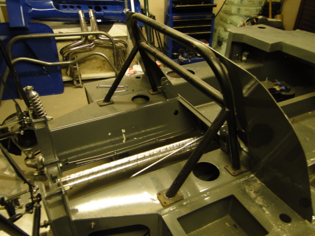

As I bought my RCR in bits second hand, I thought that the roll bar was incorrect. However, from the pictures attached, it does fit the chassis perfectly.
The only thing is, it looks different from most of those I've seen in the build threads, in that it does not enter the cockpit area like most. It sits behind the bulkhead.
Do any of you guys have the same and does it cause any issues (although I can't imagine why it would).
All the best,
Graham.

Hi,
yes this is normally inside, you may want to check the height in relation to the roof section, also consider the upper seatbelt positions,
The IVA are very fussy on mounting height and position, relative to the seat.
And rightly so,
Also the standard seats need to be slightly higher, this is the height of the seat top relative to the cushion,(the bit you sit on.) about 50mm
Goodluck
Ron McCall
That is the standard roll bar that comes from RCR. I have that in my car (although I have since added the front section to it to make it a full roll cage)
I have a tall deck engine in my car and the distributor required a small notch to clear. It shouldn't be an issue with a 302 based engine though.
Hi Graham,
as Ron already pointed out correctly, the standard with all Kits is the 4 point rollbar you have on yours.
The optional 6 point rollcage has the main hoop inside the passenger compartment in front of the firewall.
