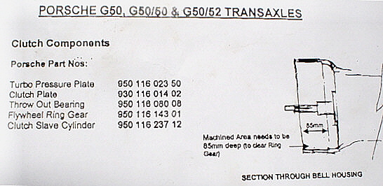

A message to Chris (Flatchat )
hI Chris , I met you 15 years ago at Ipswitch to collect an Adaptor plate and flywheel for my project .
Well would you believe it i'm actually onto it.
The setup is Std SS LS1 to G 50-01 .
questions are --- Clutch - would the std turbo setup do ?
Ring Gear / Starter - where to source ?
I got the box from the States years ago and the clutch arm was not in there , Source ?
Regards to all ,
Steve
these part numbers or their best equivalent are what works best with our adapter kit
source :- E Bay or
[email protected] Stan Adler (Is where I get this stuff from)
