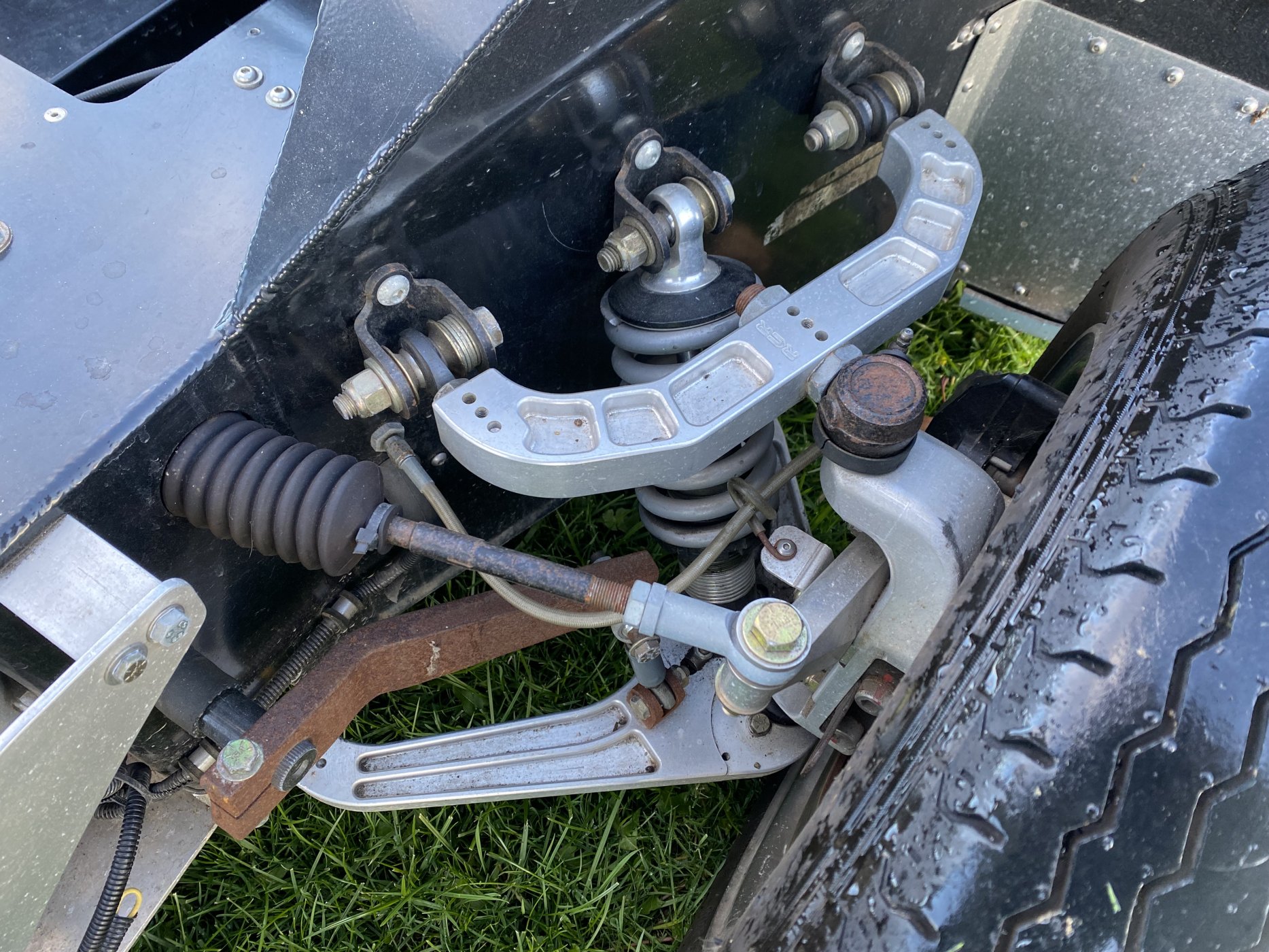

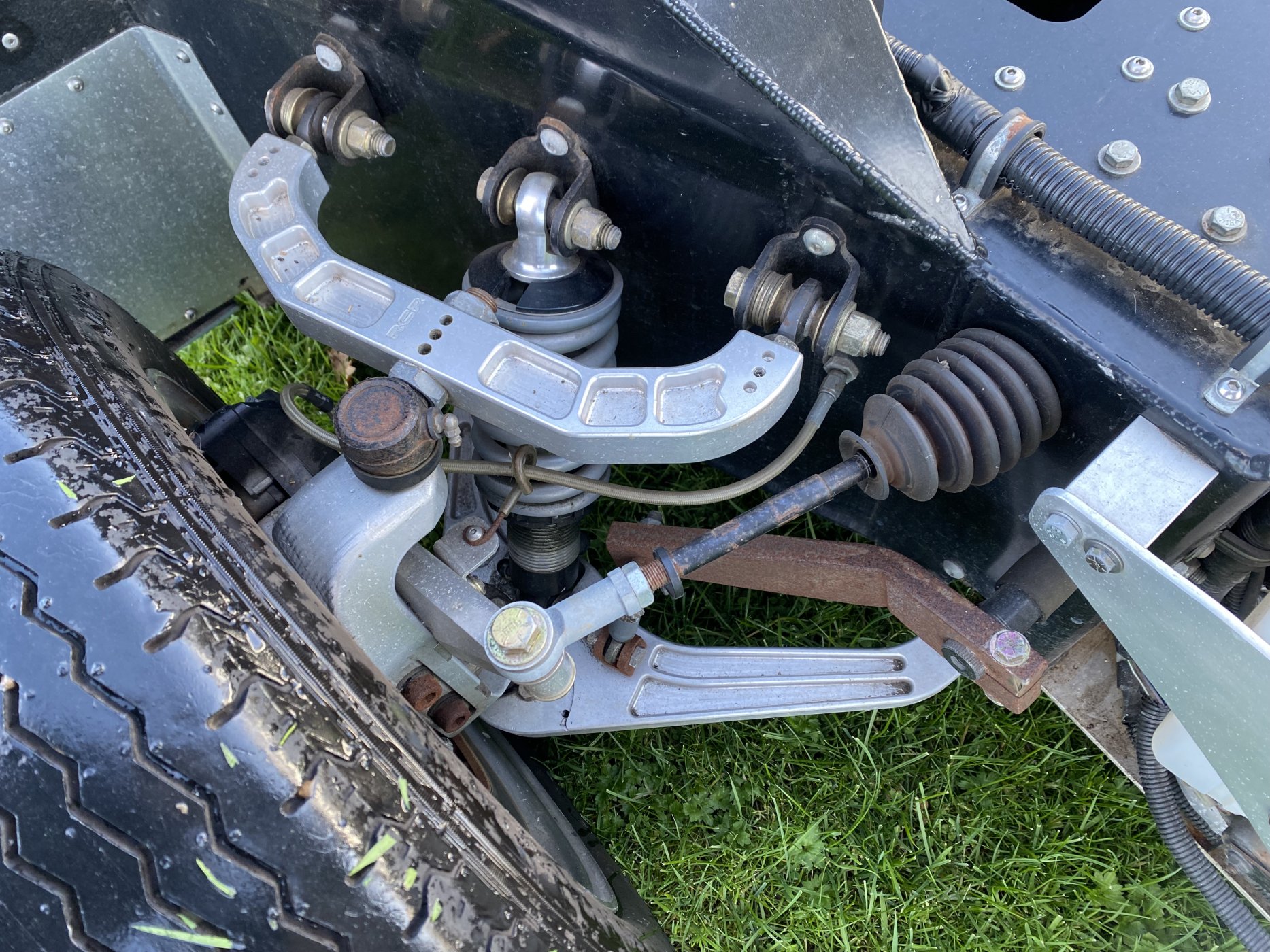

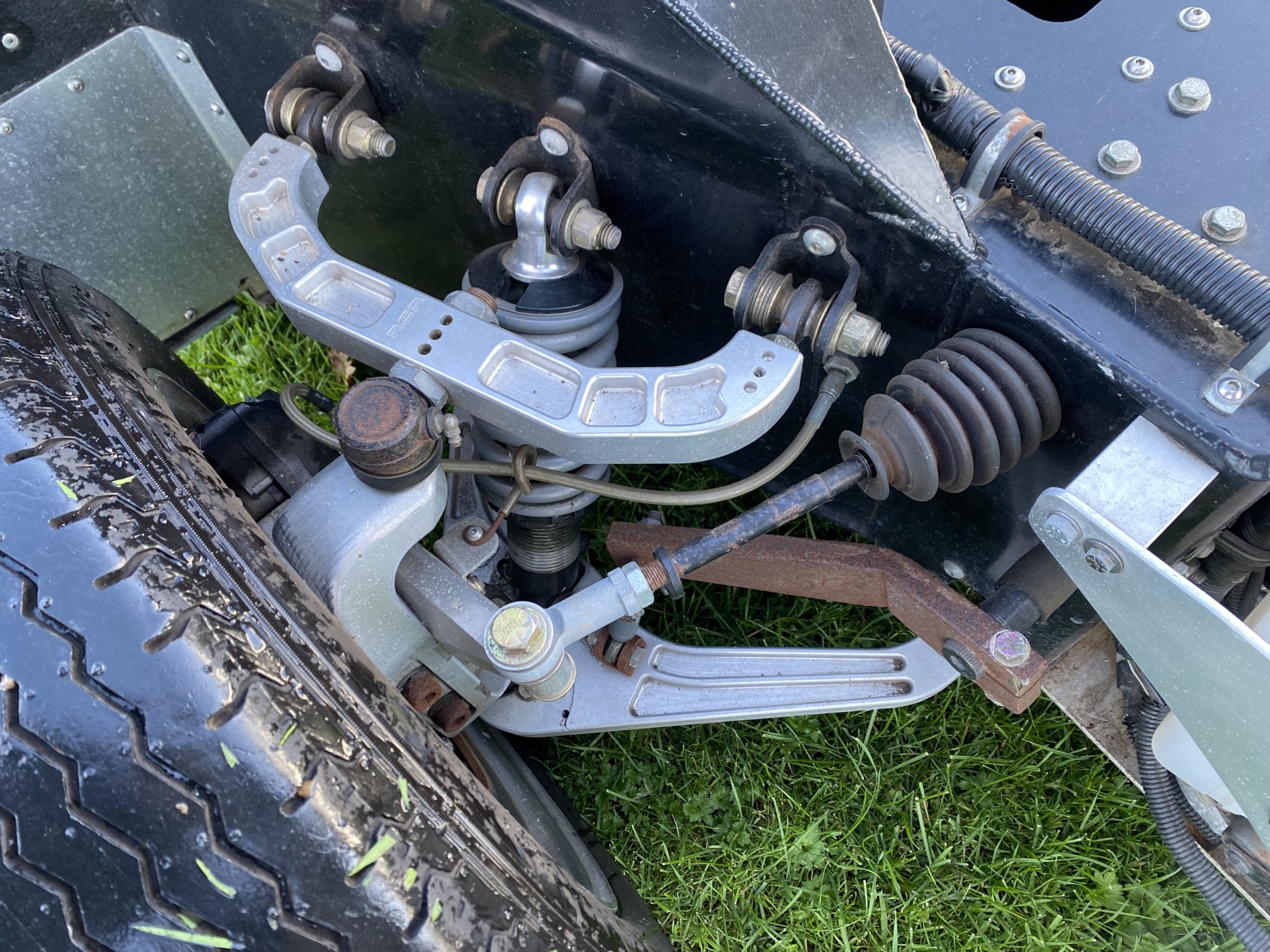

See what I have on the front, (the rust is no more present ! :) ). The bar is going though the front of the central cell just behind the pedalbox and is attached on the aluminum wall.
On the back, the bar is not installed.
Anyway, I do not fully agree with Ron. The advantage of a sway bar compare to the rest of the components of the suspension, is that it creat a link between suspension left and right. Any other component is acting separately on left or right side. My experience on race track with other car than GT40 is that the front sway bar is very important because it is active when you enter in the curve and the transfer of mass on the front is at the finish stage. The back is less important. And it is true what ever frame you have, very rigid or not.

Hi: I don't think you need the sway bars for the street. In particular, the car tends to under-steer anyway and when the tail comes - it comes ;-). However, if you like to see John's installation at the rear, take a look at the photo in my build log. The RCR front setup is as shown in the 2 photos by Jean-Marc.
