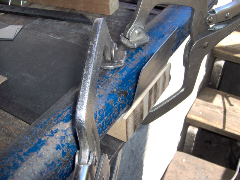

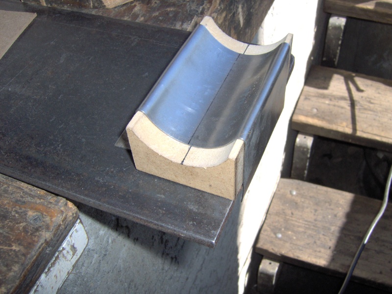

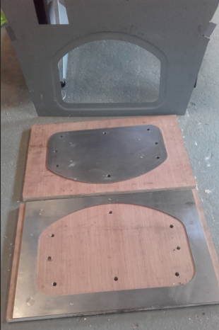

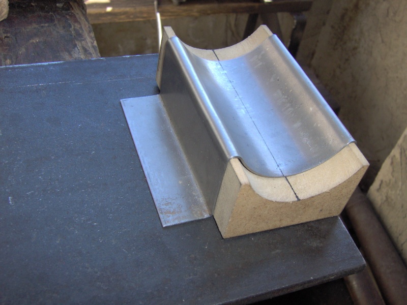

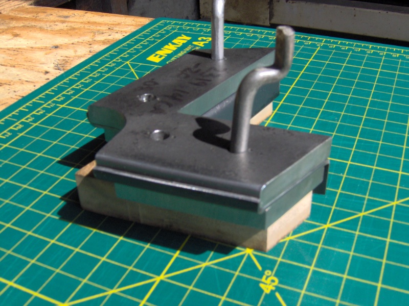

Over the the last week I made the hammer form for 2443 Rear Window Frame and the pattern for 2549 Glass. I intend to RTV some 3/16 or 1/4 steel to the hammer form surface this way it will hold up to use.

Got the steel glued to the MDF with RTV, settled on one eighth steel. Radiused the edge, sanded the surface and ran a file over looking for high spots. I was able to buy an offcut for $2.20 CAN a pound.

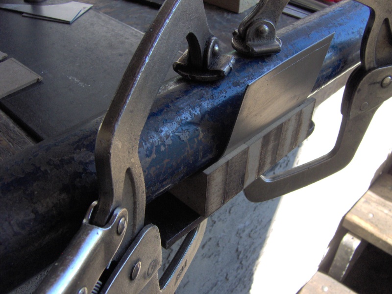

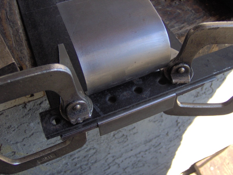

2443 rear window frame. With the 20ga steel blank clamped and pined it's time to start tapping the steel over the form. IM000011 is the first pass. IM000014 tucks develop and the low tuck must be pulled out and more tapping to get IM000018.

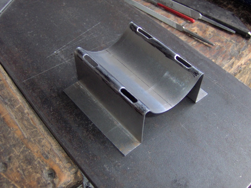

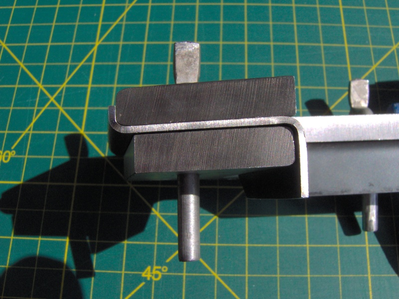

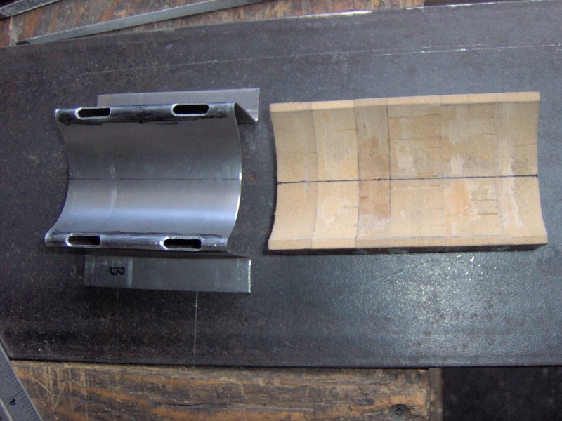

2443 Cont. Put the blank back on the form after trim to get the corners in more. Very light tapping on the dolly to get the corners in even more, tap to hard and the metal will stretch in a area you want to shrink.
